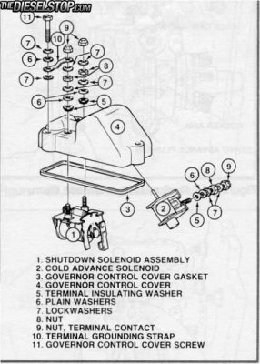

If you remove the IP check valve it can drain the fuel return on the drivers side to tank, specially if the duck bill is missing in the tank. The FSS has nothing to do with the check valve. The check valve is opened by fuel pressure with in the IP. 1st pic is the cap parts, next two pic's is the check valve.

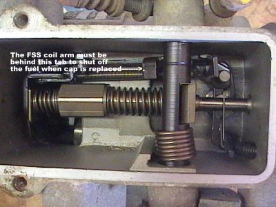

When the FSS is energized it opens the fuel shut off valve in the top of the IP. In the 4th pic, notice where the FSS arm has to be to shut the fuel off when the solenoid is de-energized or let it open when the solenoid is energized.
