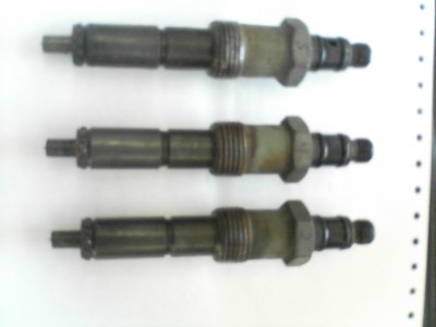

Ok, got some pictures of 3 of my injectors. I've been running 100% WMO for the past 2 months and 2500 miles. The past tank ran through it was about 80% trans fluid though. If the injectors are this clean, does that indicate that the cylinder/valve seat will also be the same?
Oh yea, these are injectors from the 2, 4, and 5th holes.
