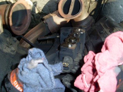

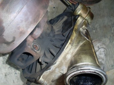

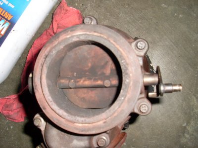

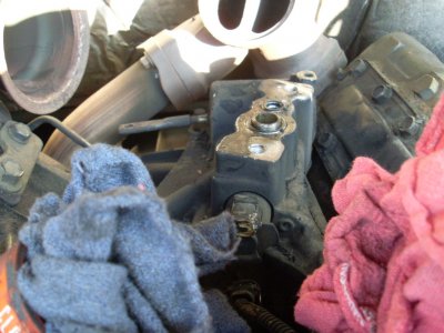

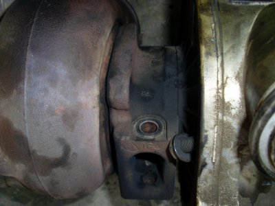

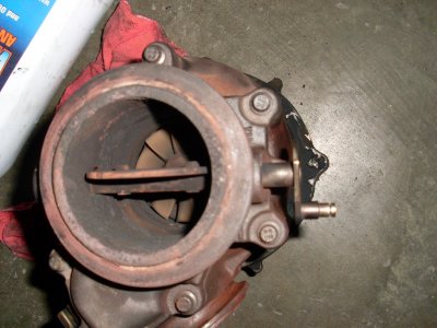

I have a 10/98 F350 in my posession right now with a bad turbo. Two of the exh housing bolts fell off and caused the housing to lock up the impeller. The whole thing is off right now and I have a chance to deal with the EBPV acutator. Out of curiousity, what harm is there is wiring open the flapper and cutting the acuator rod and keeping it plugged in?

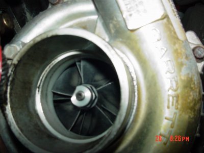

Yeah,
I don't think mine is bad yet..... I do have up pipe leaks? How does my turbo look?
No huge harm Cal, what you might find though is that the actuator arm may develop an oil leak from just dangling in air. I had mine unhooked like this for awhile and ended up developing the leak. If youve got the turbo on the ground right now just pull the piston/actuator, take a 1/4" pipe tap and tap the hole where the rod comes out and run a pipe plug into it and be done with it.

Homer beat me to that Cal :D.....but in addition, re-seal the opposite end of the piston bore---where the snap ring cover is.
You have the EPBV exposed so just cut the rivets, nip out the shaft and use a 3/4" cup plug....
