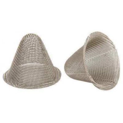

Glad hand screens, squeeze top around tube, clamp or wire to it, I run a wire up to the bracket or tube to hold it up .

... I run a wire up to the bracket or tube to hold it up .
Like baling wire?

Know the return hose will not work. You need to use truck air brake tubing and as said push it on there as far as possible and even put a worm type clamp on it will hold it on there but I like the crimp type. And then keep trimming it until it's just a little bit off the bottom sliced at an angle
