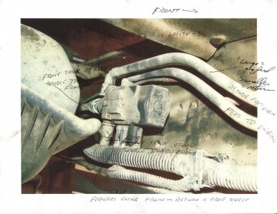

Some members have eliminated the FSV and run only a single tank. If you have only one tank there is no need for the FSV. Ba absolutely sure that you have the lines correct, so that you draw from the tank you want, and return to the same tank. I'm not sure how you want to connect the selected lines at the FSV. I'll let somebody else tell you that. Basically, it should be a simple matter of putting in two 6 inch splices, one for feed and one for return.
I'll toss in another picture here, of the FSV on my '92 CCLB. I've labeled the lines, if you read carefully. Not all the labeling is clear. BE AWARE, my picture is from a '92 model year truck. Your '86 may be different. I don't know. My '86 is 3000 miles away, so I can't look.
