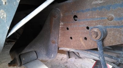

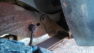

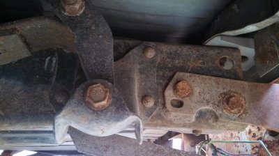

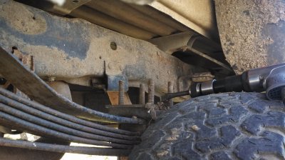

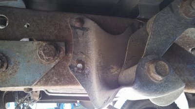

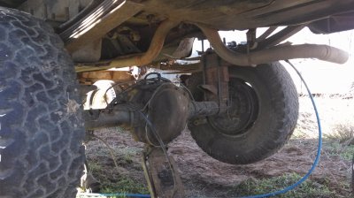

Hello all, new to site i am in the process of swapping out all the half ton
1989 f150 suspension for 1 ton running gear including a cummins swap with
a c6 auto. The truck has 2.5 in rear leafs so iam swapping hangers with the
Sterling 10.5 and 6in lift.These springs are 3in wide. The front will sport a kingpin dana60.
This is all bolt on no fabbing needed. The f150 front hangers only have 4 rivets The donor
F350 has 6 rivets so ill have to drill out 2 holes.The rear bolts right up with 4 bolts.
All 1/2 in grade 8 bolts.

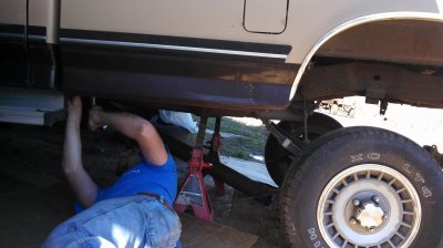

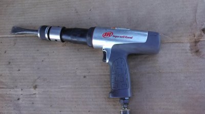

Nice work on the swap.
Couple things......
1. Even with the 1 ton running gear, you still have a half ton frame. The half ton and 3/4 - 1 ton frames are different. The 3/4 - 1 ton is stronger. So you do not have the capacity of a one ton, still just the half ton.
2. With that huge stack of blocks on the rear (most here don't like anything taller than the 4" factory F-350 blocks) you are going to get a TON of axle wrap with the torque from a diesel, you will probably have wheel hop from the axle wrap.
