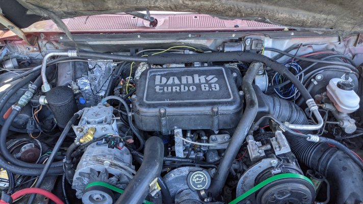

Hello everyone. Finally got my first diesel, trucks info in sig. Originally was looking for a powerstroke, but decided to go for the idi and slots of research. Picked her up in Houston and drove it 3 hours home to San Marcos. Lost the alt belt just out of Houston, so made almost the whole trip with no brakes, that was fun. Then stalled from air intrusion in the middle of the night coming back from new Braunfels on my birthday. Smoked the starter trying to purge it. That was awesome aswell. But so far loving the truck. Completely replaced the glow plug system with Napa controller, Ford plugs and Classic Diesel Designs harness. Just put in new moose buddy injectors and their return line kit. Just need to get the pump timed, pretty sure it's off a bit as she's still a little smokey, anyone around San Marcos know how?

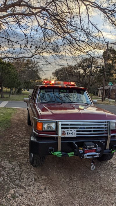

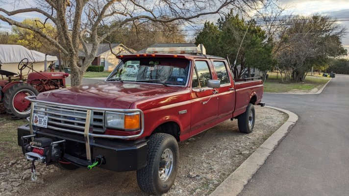

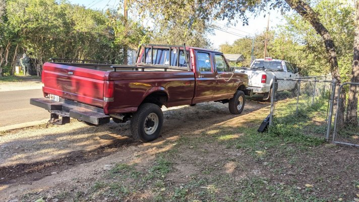

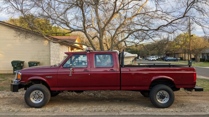

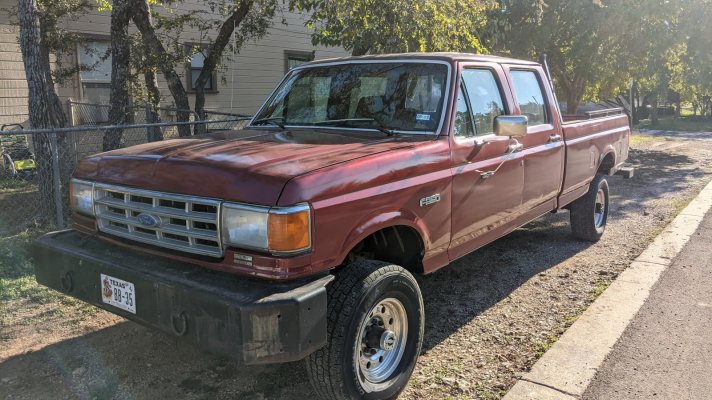

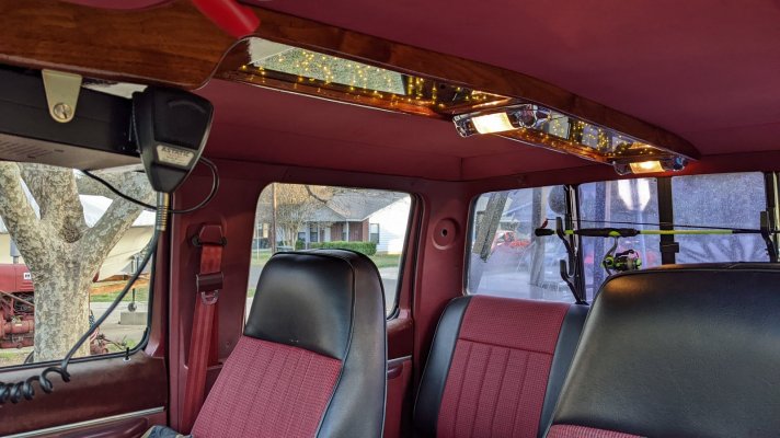

This is what she looks like, have a few things lined up for her, CB radio, tool box out of other truck, centurion overhead console and remote start/keyless entry to start off.

Air Intrusion, either a ruptured hose right before or after the lift pump or loose hose clamps, possible O ring compromised at the injector fuel return caps or loose injector supply line is where ive always found it. and do yourself a favor, install a clear fuel line from the filter housing to the fuel return rail on the passenger side of the engine. it helps determine where the air intrusion is before or after the fuel filter.

Thanks for the tips! I already rebuilt the fuel lines from the ground up, dropped both tanks and ran all new line, hoses and clamps. Put new injectors along with the return line kit from moose diesel. No more air problems that I can tell now! I didn't do the clear hose though, if it acts up again I'll try that. Just smokes a good bit. I talked to CDD and he said he can help with timing it next month. Also ordered their glow plug harness when I re did the whole glow plug system, so she immediately starts right up every time now.

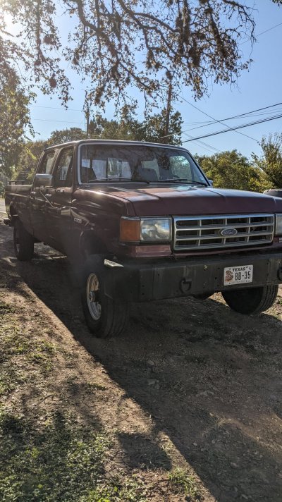

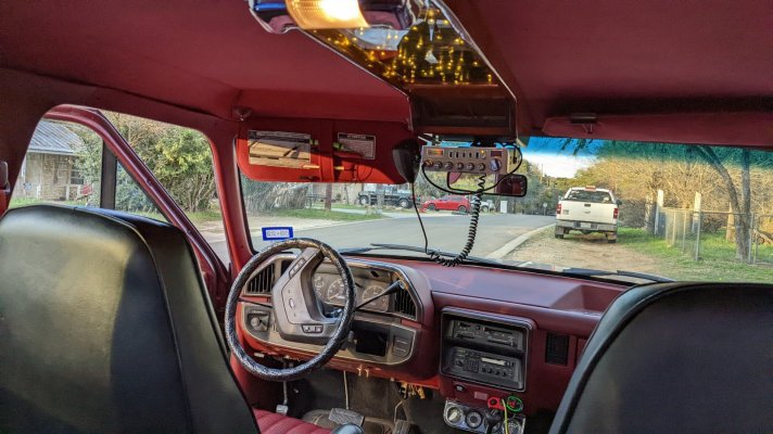

Welp, I've done a few things to her.. What do y'all think?

Great looking truck. I have and 89 7.3 450. Canyon Lake. Just starting to change the injectors. These are the original. But my truck is butt ugly work truck. Bought in Abilene for 700dollars. Has 107000 mile. Old wood haulers truck. You figure it out .lol Jack King.
