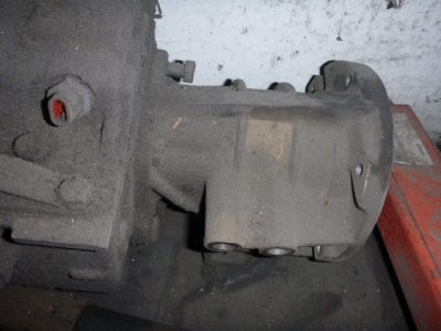

Not a very good picture, havent had time to pull it all yet, truck is 60 miles away at my friends house, closest point to the mountain we towed it off of.
As to how it happened, not a situation most will be in and also probably not the smartest thing but boys will be boys. Racing my buddies Cummins across a WWII era dirt mountain airstrip at 70+, it got a bit bumpy near the end.

Yes, that looks like the longer np435 version but its hard to tell.
trust me on this. a BW 1345 was tied to the ass end of this trans.
what you need to pay close attention to is if yours had one or two mounting bosses on the driver's side for the transfer case shifting mechanism.

Towcat, he meant that the transmission looked like a NP435, he wasn't questioning a BW was on the ass end of it.
As far as mounting bosses go, in my oservations the single-boss setup was always used with a NP208 transfer case, while the 2-boss setup is for BW cases. With the single-boss you can pull the shifter from 2wd straight back all the way into 4x4 low - not a big deal if you're paying attention, but you see the potential for destruction. When the BW cases came about Ford also switched the shifter mechanisms to the style that requires you to move the stick to the left in order to clear the gate for neutral and then 4x4 low (thus preventing goofballs from shifting from 2wd straight into 4x4 low and destroying stuff). That is what the 2-boss setup is for, the front hole is for the shifter's pivot pin and the rear one is for the bolt that secures the gated plate to the transfer case.
Considering he mentioned in the first post he has a BW case, I'm almost positive his adapter housing is the 2-boss setup.

It is a BW case but the shift linkage only uses one large mounting hole, also I can pull the shifter straight forward and back into gears.
