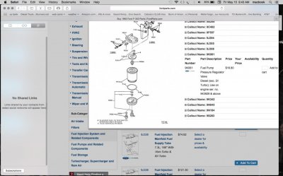

Ford parts diagram is calling it a pressure regulating valve showing the spring and ball type also note it says engine serial number 943929 and above. So maybe thats the answer to which ones have spring type.

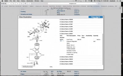

The last post I pulled up diagrams for a 93, this is for a 90. Note the serial number and it says valve only no spring or seal required. This was from fordparts.com website.

Pressure regulator... So perhaps a weak spring was allowing mine to stay open...
