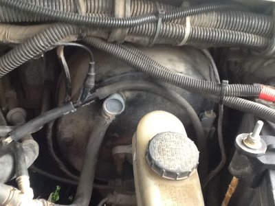

I am traveling South America, currently in Ecuador. My brakes are marginal (seems like a vacuum leak). the most likely culprit at the moment is the grommet around the brake booster check valve, and maybe the check valve itself. There are no Ford dealers here, and part shops cannot figure out if they can find these parts without a Ford Part Number.
Can anyone please tell me what the correct Part Numbers are for the Brake Booster Check Valve and the Rubber Grommet that seals it as it enters the booster?
1993 E350 Ambulance 7.3L IDI
Thanks a bunch for any help!

i would pull it off and check the check valve.
its a dirty job but blow through it and see if it holds air.
inspect the gromet for cracks, in my experience, if youre having a vacuum problem its most likely the booster itself.

ThanksIDIoit. The grommet is very cracked up and is obviosly leaking. I do not want to pull out the check valve becuase the grommet will dissintegrate and them I will be screwed. As of now, the brakes still work marginally. If I lose the grommet, they will not. The first thing I need to do is get a new grommet, but I need a part number, which I cannot find so far. From what I can see, it looks like the check valve and grommet come as a set.

I never physically compared they but if memory serves me correctly those check valves and grommets where the same on almost all ford trucks and cars especially the full size Ltd, Lincoln, Torino etc. So find a wrecking yard and compare them. And bring me back one of those old style ford pickups with a diesel in it, well at least send some pictures.
Lots of good ideas posted so far. sorry I have no part numbers for you but try this. Buy some RTV and really slop some completely around the cracks. Clean off as mush dirt as you can. Allow it to cure and test the peddle again. If its still a bad brake peddle then you have a bigger issue and its probablt the booster seals around the peddle sram. Nothing you can do then but replace the booster.

That check valve is a generic part. Only variation is the diameter of the hose fitting. Perhaps a general auto parts store will have it.
Is the brake pedal unusually stiff?

MadPogue - the brake pedal fells fine unless I press it a few times in a row, then I lose vacuum and it gets really stiff with not much braking power. Sometimes first drive of the day, I have to do what I call Brake Yoga (give it gas and slam the brakes on a few times to loosen them up) or else they are super sensitive and want to stop way too fast with slight pedal pressure. Maybe I have a piston in a caliper sticking or something. But as long as I do my brake yoga, and dont press the pedal more than 3 times in a row, they work and feel fine.
With what you just posted about not using the brakes 3 times in a row tells me your loosing vacuum. May want to check all the vacuum lines and test the vacuum pump. You might have a bad leak or vacuum pump. The fuel price seemed great but the next country sounds like it will suck for fuel costs.

If you get real desparate, you might be able to use a piece of hose with about the right inner and outer diameter. It just needs to seal. Big dab of silicone might do it too.
