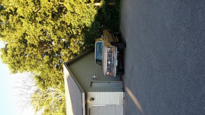

Took her for a spin today, only to find out that the fuel block off plate (big block chevy) does not seal, AT ALL...
Any suggestions? Is it possible to put it inn upside down? Here are a few pics...

Ummm. Don't ask me how I know, but it is absolutely possible to put it in upside down. If I remember right, the longer end goes up.
Yes, this is possible. BUT ALSO! There is the distinct possibility of the plate being too big. There is a machined lip above the hole that some brands of plates hit against and bend, therefore not sealing at all. I speak from experience. I believe a Spectre brand block off plate is the one you want....

Sir, you were right, it was too big, spent about an hour filing it down, and matched the gasket to the old lift pump (thank god the garbage truck hasn't come around yet) :) Now it fits!! And does not leak, regarding the gears, they are indeed 4.10's Oh and I also noticed that it leaks a little bit of coolant, probably out of the block heater insert!
Here are some pics, cleaned the interior and the outside the best I could, it also needs a new headliner, which will be the next project after I sort out GP issues and the coolant leak. She has to be ready for the 24th (college)
Sure pleased someone explained the block lip leak issue some end up with. Nice easy fix too once you know what to look for. Also nice looking rig. I always liked this color combo.:thumbsup:

Hah thnx pal, yeah it was just a matter of a few millimeters that's all..
