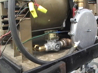

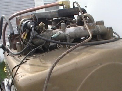

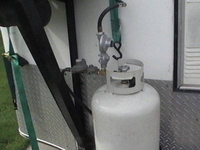

I'm actually running a gas genset on a trailer with propane without a regular propane carb. Just feed the propane in similar to what ziggster did with a copper tube with holes drilled in it. I bought the propane regulator and valve off ebay, little expensive but safe. I feed the propane fro a 40 lb bottle thru an RV regulator, then to the regular gas engine regulator. Works great, should work on a diesel just as well.
