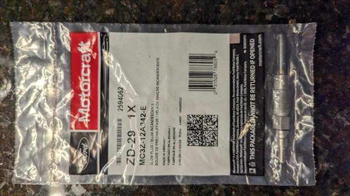

Time to do GPs and saw the lack of ZD-9 availability and the controversy about ZD-29s, so I thought I'd try them and start a thread.
I bought 8+1 from Rock Auto to minimize the chance of counterfeits. They came in individually sealed Ford Motorcraft bags. The bags say, "Made in Germany". The plugs not say "Beru" but the one I looked closely at had the following legit-looking markings:
ZD29
E2510 061143
2216
10.5V
Most importantly, all 9 measured either 0.1 or 0.2 ohms.
2019 was the last time I replaced the set, and now I have the dreaded relay clicking so it's time to replace them. We shall see how the ZD-29s do.
