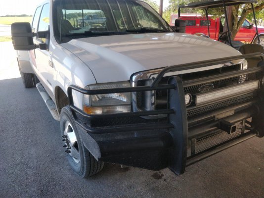

Pic for context, waited 7 months for this truck because the PO wanted a 2022 and it took that long to get one.
