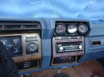

Sadly you are learning what many already know. The factory gauges are not much to watch. Aftermarket gauges be it electrical or mechanical will tell you the truth. No more guessing.
374
A hot IDI makes about 20-30 PSI at road speed. If your lucky, you will have 10 at idle. I recommend the ISSPro brand gauges. I prefer the electrical over the mechanical ones.
All electric isspro EV gauges with the 270 degree sweep. The boost and pyro are from Banks.

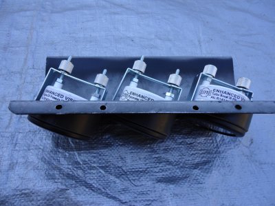

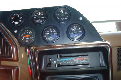

I plan on it I want a 3 guage piller pod if I can figure out how to make it fit for when I get my turbo put on or if anyone else has any custom guage pod ideas lemme see them
Sent from my Iphone using Tapatalk
TahoeTom
May 19, 2010
749
113
S. Lake Tahoe, CA
Here is my setup for slantnose. 2" ABS fits 2" gauges. I cut it to angle to aim gauges.
