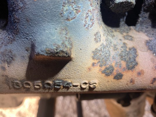

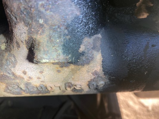

I will have to look at my other truck, which is at another site. They may have casting numbers on it. Could you sent me a picture of the ones you have?

Here is a picture of my other truck same model. TNBrett, standard truck will not work. It has to be from a large van or dump truck.

It sounds like you need manifolds of an s1654. Look for an old international U-Haul truck, they should have the correct manifolds.
There are a few on marketplace right now for parts.

Farmer Truck,
Yes, that is exactly what I need. But didn't know the numbers. I will begin looking for that number. I also wonder if they make headersfor the same?
