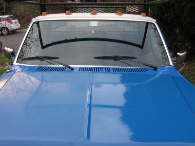

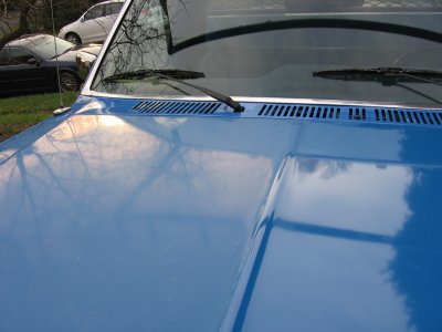

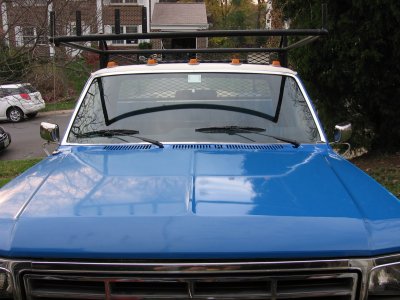

I spent some time cleaning the truck today. Got her in March and today is the first time that I took the time to wash it :eek:
I decided to see if I could get some of the oxydation off of the paint. Here are a couple of pictures. you can easily see the before and after on each side of the hood. Came out pretty good ;Sweet
I used a Porter Cable DA polisher and a few different compounds. BTW, the pictures were taken before waxing the whole thing so now it's even shinier!

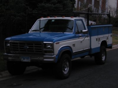

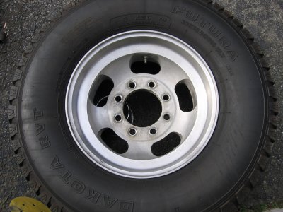

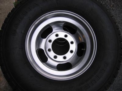

I spent some time on *one* of the wheels today and got pretty decent results. Here are a couple of pictures of that. (Before, After and whole truck - sorry no flash...)

I used the same Porter Cable DA sander/polisher with a 6 inch sanding disc. I used 600 on the whole wheel to get the heavy crud off. Then I switched to a fairly stiff foam polishing pad and used some aluminum polish left over from my aircraft mechanic days. I just let the polisher do most of the work. Last step was hand buffing them with a microfiber cloth just to get the residue off.
The wheels were on the truck when I bought it. I think they are American Racing and about 9" wide :eek:
