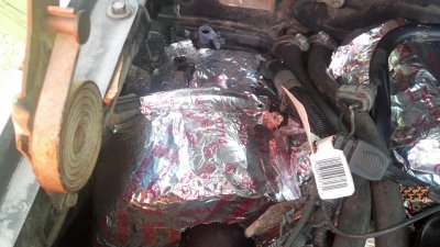

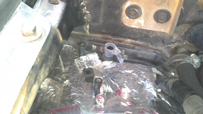

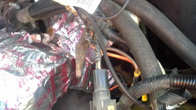

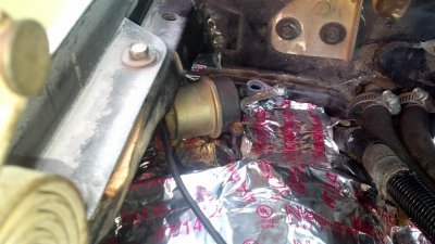

I took some pictures of the process of covering the "junk" with the insulation...
But before I post the pictures, I want to answer The Warden's questions...
My thermometer has two inputs, one inside the actual body of thermometer and the other in the form of a remote wired probe with about ten feet of wire. It was this remote probe (for outside temp) that I shoved into the ductwork inside of the dash. This probe is where the thermometer gets it's data for it's 'outside' reading and since it's now inside the ductwork, it really is measuring the temp of the air post-evaporator.
While I have the 'outside' probe measuring the inside ductwork temps, I have the actual thermometer measuring the cab temp via the 'inside' display window.
What I've actually done is, I guess, is reverse the function of the thermometer... Inside is the cab and outside is the ductwork. Nothing in the cowl at all.
Although I could run the remote probe into the cowl, I already know that the outside air does get hot because the sheetmetal of the hood and cowl gets hot.
As for A/C temps pre insulation, I don't have those numbers, but I can verify that insulating the junk is helping bring the temps down.
Okay, it's A/C ***** time!!!
attachment.php
I shoved the wires and hosed over to the accumulator and removed the vacuum actuator that works the blend door. This gives me more clearance for my big fat hands...
attachment.php
Lotza room!
attachment.php
I insulated the ductwork in the part of the box where the outside air flows past the blend door. The insulation might be super sticky, but I wasn't happy with the way it would pull away from another piece of insulation. I used Aluminized duct tape and even then it didn't want to stick very well. My answer was to tape everything so that all you could see was the tape itself!
attachment.php
This is what it looks like with the vacuum motor back in place. Looks good, eh?
attachment.php

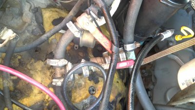

Here's my heater bypass... I installed this way back in the summer of 2009. This is about the best thing you can do in terms of reducing A/C vent temps. Just this alone was good for ten degrees!
