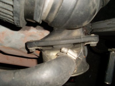

There are no washers under the cdr bracket those are bumps made into the casting where it's threaded. My 92 didnt have a rubber washer?

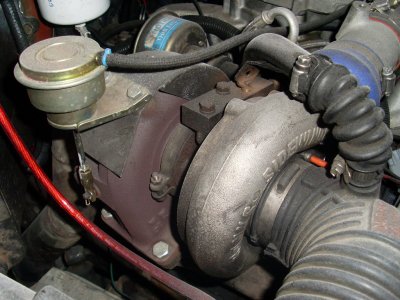

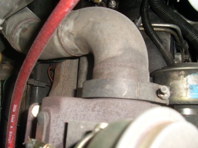

you're missing the rubber washer gasket that normally goes from the CDR to the intake manifold. see pic. your pic is the same standard turbo Banks puts in their wastegated turbo hit. here's another pic of the same turbo only difference I mounted on a factory GM6.5 turbo motor. It takes a fairly quick truck and turns it into a banshee. I can nail 10psi at 1500rpm:eek::D
you put a 7.3 turbo on a 6.5 motor or a 6.5 turbo on a 7.3 motor? sorry i is confused.

I feel like I was mislead. Oh well. I'll pull the cdr blockoff tomorrow and see if I missed the gasket
