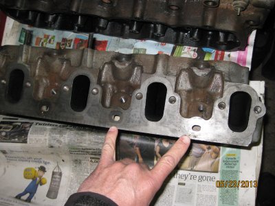

Valley Pan Gasket?
I'm thinking maybe Valley Pan gasket. The heads have coolant holes cast into them on the intake side. The early heads used the valley pan gasket to seal them. The later heads had plugs in them. This is a known problem with the gasket rusting out and leaking. I'm not sure what year the change was made, but someone in the collective will probably chime in with that wisdom. :)

Thanks for that information Jordan. I will pay attention to that area as I tear it apart for the LAST time.
