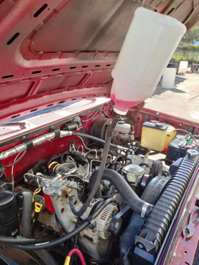

I just now had an issue with an intermittent engine miss. Engine idling really smooth, then you can feel a miss. Blip the throttle and it goes away. I assumed it must be an injector or injectors, just not sure which one. I have read about this ATF trick and decided to give it a try. So I set up an ATF IV Drip! Ran a couple of quarts thru the system, and stopped the engine as it was running out and left it filled with ATF overnight. Hooked fuel lines back up and tried it today. BIG difference. Runs really smooth now. So yea, it really does seem to work. Might help even more to leave the ATF in the fuel system longer than overnight if you can.
