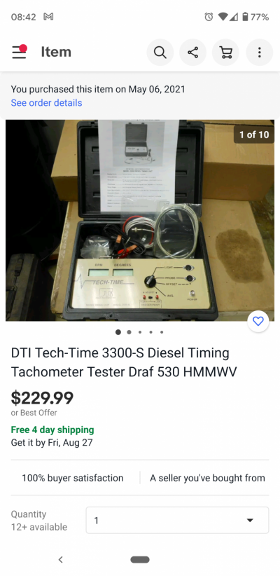

You need a timing device of some sort. The marks on these are for reference with the original pump. Your new pump needs timed correctly and a new mark made.
You need to have it timed sooner rather then later before you ruin something.

I agree, the original timing marks on the pump housing do not mean much at this point. To properly time the truck it has to be checked with a timing meter.

You mentioned you think the timing is off, too advanced. These trucks are very timing sensitive. A limited few, maybe 5% of the membership, had luck setting by ear at cold start. Some suggest they can get a pump +/- 2* but even they don’t know what theirs actually is. Since you are a mechanic by trade you know the importance of having the right tools. It‘s easy to be the cobbler without shoes as a tradesman but in this case you really need to start knowing your truck is 8.5-9.5 degrees BTDC at 2,000rpm. (Try to do that by ear.) Once you know the pump timing is on, you can move forward from there if your high rpm issue is still there.
