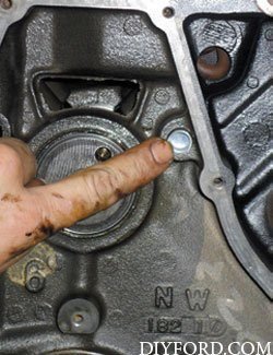

And im probably calling them incorrectly, the plugs behind the cam cover plate in the rear that feed the mains

need to zoom back so I can reference what you are pointing at
