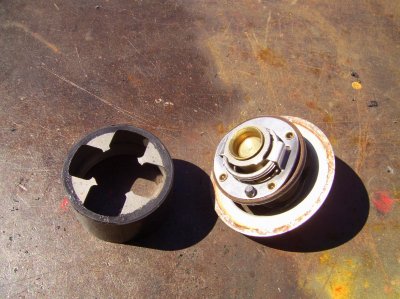

The fact that it pushed the coolant out the bottom told me the thermostat had failed closed. Tow it home and pull the thermostat - it had mechanically separated and I guess the pump pressure held it in the closed position.

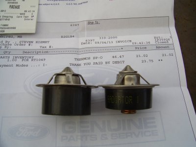

Welcome to the forum. That note about the po changing the thermostat and you buying the rig. then you heat up the engine. Then towing it home safely and removing the thermostat. Well the pics tell me thats the wrong thermostat for sure. your posting is not too clear but I feel if you replace the thermostat with a 192 degree factory correct one it will be fine based on what I think you posted here. The factory part number is listed in the parts bin forum but here it is off the box. RT-1049 E5TZ-8575 C... The 8575 is the Ford part number for all thermostats they make.. The E5TZ is the model and year engine this stat fits. Don't have any idea what the RT-1049 means. These numbers are found on the end of the motorcraft box.

My problem with the aftermarket thermostat is that it is too long. When it fully opens it hits a high spot in the block which flexes the metal which then quickly fatigues and breaks and then the sleeve of the thermostat is held closed by the pump flow/pressure.
It also seems that I am missing my cold advance, fast idle switch. Did any of these engines come without one? It seems and odd thing for someone to remove??
Anyway put in the correct stat and the truck runs really well. It appears no damage done - yeah!
Put some mechanical gages in that I had laying around. Engine runs at a pretty steady 190 and 40 psi at cruise - 65mph.

Thats a great pic of the correct stat compared to the wrong one. also that hole in the underside of the thermostat cavity is the bypass. When the stat is cloed coolant flows thru that back to the water pump. When the stat is open it grows down to plug that holes fairly well stopping much of the flow bypassing the top of the radiater.
