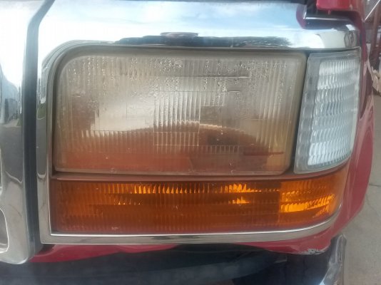

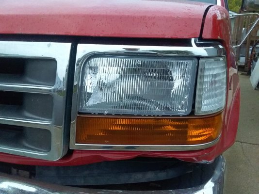

This is my before and after. Bought them from rock auto.
