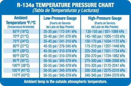

If you don’t have access to temp/pressure chart.
Low side will be 1/2 ambient temp and high side will be 2 x ambient temp + 10 this will get you close.
