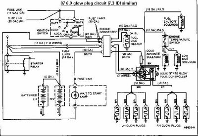

Should just be the controller. Someone else will know more, I fixed mine by eliminating it and manually controlling the glow plugs. Its way simpler and it will outlast the controller by years. And it starts better in cold weather.
cleithau
Dec 5, 2007
234
Northern Michigan
It said 87-94 on the caption when I saved it to my comp. Should be right.
