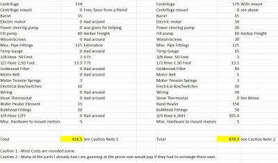

i did a real rough breakdown of my system cost, it was built over time with some scrounging and cannabilizing of my other system. with enough scrounging costs can vary drastically depending on how much you can find and how fancy you want to go. i also did a rough break down of the estimated costs if you just bought all the parts to my system.
