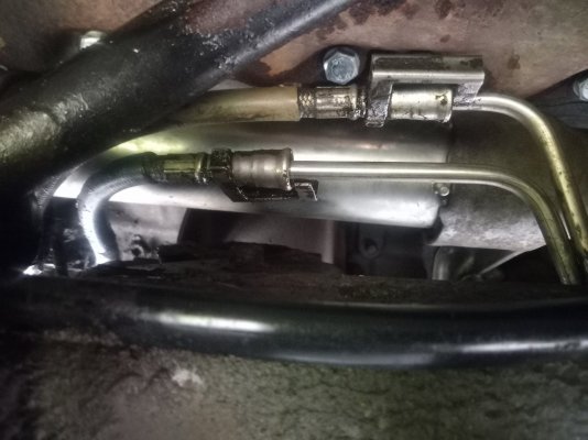

Hey all, finally got my 96 F350 back from the shop. more engine work than we thought but it is what it is and she is ready for work..
one thing i was trying to find is where to get the fuel lines that run up to the fuel bowl.. if you look in thru the drivers side over the wheel you can see where they connect and the mechanic said it was possible the orings dried out while the engine was out.
said a small fuel bubble of fuel would form but said nothing dripped over night, i have run it the past couple days and apparently those orings have swelled back im not even seeing a fuel droplet form on the bottom of where they connect together.. i thought i would get those and have them on hand in case these start to seep etc..
Anyone have a source or place online. he said i could find them online cheaper..

the lines go to the lift pump.. sorry i for some reason had the dang fuel filter bowl in my head..

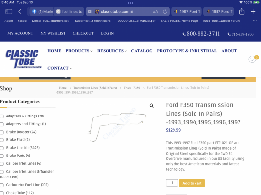

I think these are what you’re looking for. This picture is from Riff Raff.

got to looking the ones i need are the lines on the left side, of course these that are on it could be after market and not OEM metal lines.. dang talk about confusing

Is your truck an automatic? The metal lines on the passenger side should be transmission fluid. Are you able to trace them to see where they connect?
nope its a 5 speed..
i found out it is the braided Blue and Grey fuel lines i need..
Thank you for your help and those on riff raff are the correct ones
