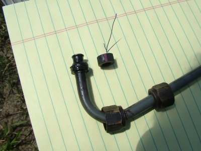

The International part number is 1815780C1.
I even have a picture of that end of the hard line, the end which joins the IP. The old olive is on the hard line, and the new olive at the end of the arrow.
Ken, thanks for the great picture. I'm sure now other members will know what an olive actually looks like. Nothing better than a clear picture of something. A blury picture is the most worthless thing in my opinion posted on the forum. Not attempting to single any person out. Just trying to get a clear picture posted that we can actually see and not wonder... WTH is that fuzzy mess....:sly:D
Last package of the olives I got from IH dealer was 5 for $2.86. Cheap, same PN as above.
