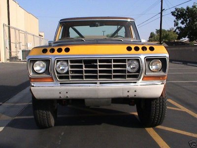

I love those rear disc breaks!
Anyone know how to do that?
With the D70 of course.

I used to have the magazine that truck was in. At the I thought it was cool
It still is. Nice to see a truck like that servive till now. Just think when it was built,that was cutting edge tech.

thats a sweet looking truck, needs cleaned up a little and i would put a good front bumper back on but me likey.:thumbsup:
