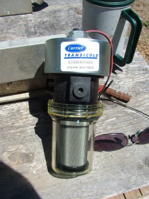

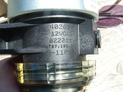

Would anyone be kind enough to give me a part number for the exact pump model I need?
Here is a picture of mine. The part number is there. These are used extensively on OTR trucks with refer units. Those trailers must stay cold or the load spoils. These pumps feed the cooler units for the refers. If they're not reliable the trucks companies wouldn't rely on them. They run day and night on those refers.
attachment.php
And more numbers on the side, just in case the other is a Carrier number.
attachment.php
