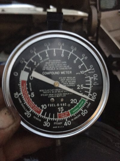

17 is low. This is what I had when I replaced my pump with a used one. Are you checking right out of the pump or at the distribution block?
I checked right out of the pump hose. I actually have that exact gauge and it's reading just at the bottom of the green at 17 lbs.
