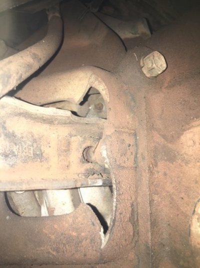

What do you guys think? How much is it going to cost to get a ZF5 into my truck in 2022? I found one is CA that about 800 but not sure if it's a gas or diesel version. Should I just make a support bracket and keep on truckin with the T19? Clutch still works...for now but i'm sure it's going to snap off soon. Funds are tight and I don't mind the swap itself but not sure I want to blow $1500 minimum on swapping to a 5 speed in a 4x4. I'll upload some pics so you guys can seen the damage.

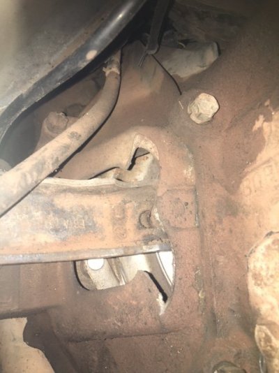

I've got a picture of it I just need to upload it. The material broke and fell out on the top and bottom and just the material that supports the pivot ball is left and the clutch still works. I do have a welder but it's just MIG I can weld steel all day but just not set up for aluminum.

I have a zf5 in my 4x4 with 4.10s and 35” tires. I really like the 5th gear, I would definitely hate to not have it. Around here (Ohio) zf5s come up for sale once every couple months, usually for 600-800. If you go that route, definitely inspect it closely for cracks. I had to replace mine recently because the tailhousing had a huge crack. They always seem to crack in the same place due to carrying the weight of the transfer case, especially if the transmission mount has gone bad.
I actually have the gasser gears in my current transmission. I swapped my diesel bellhousing over, rather than drill my gasser bellhousing to fit the diesel. There’s more to it than drilling the top two bolts, there is a tech article about it if you end up finding a gasser trans and want to convert it. If you do swap to a zf5 I have a solid flywheel conversion kit that I would sell for cheap, shipping would be expensive to AZ though.
