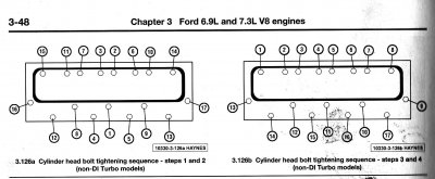

338
If your going to ARP stud it, the studs act as a guide when installing the heads, if not studs, just grind/cut heads off of about 4 bolts to use as guides, grind screwdriver slots on end for removal.
Why don't you re-torque the head bolts? Worth a try. Loosen one bolt at a time a half turn, re-torque to spec +10 ft lbs., do all just using the 1-2 sequence.
If using a torque wrench to loosen, set it 20 ft lbs above tightening torque, if it takes more than that to loosen, then it's an indication the bolt might be rusted in, remove, clean, reinstall, you will have to clean the threads if bolt is taken out, put a little grease on the tap, that will collect any rust on to the tap.
Edit: A pulley tap has a long length to go thru the head depth.
Thanks for the suggestions, Bill. I guess it would be worth a try to re-torque the head bolts. Nothing to lose (unless I were to break a bolt) but trying to loosen them would tell me what I may be in for anyway. I may put that project on my agenda for next weekend. I'll have to pick up a set of valve cover gaskets before I make the attempt.
I know in both Mel's and Tim's write-ups, they had a few of the rear bolts/studs up in the head while the head was being set on, otherwise the bolt/stud was too long to install after the head was on.
EDIT: The head bolts on the 7.3 are 1/2-13 correct?
