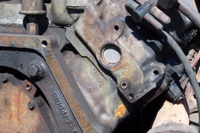

14,778
483
Mel, not sure if this is the correct area but here is a pic of the 6.9 in the ole F250 I am scrapping out. You can see there appears to be a coolant leak down the back of the engine.
Yup that's a good example there.
