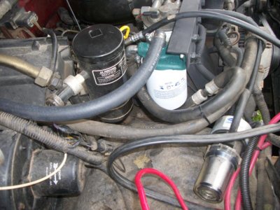

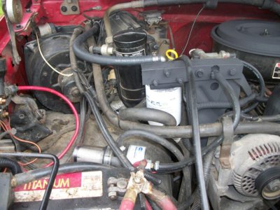

the heater core line(s) is a bypass from the main cooling system.
this loop serves just one purpose; providing heat to the cab via the heater core (mini radiator if you will)
also provides quicker heat to the trans section of the radiator for those with auto trans,but you will be joining after this section,so that remains unaltered anyway,bringing you back to simply joined with the heater core bypass loop.
so imho,the work is already done for you with no extra plumbing necessary.here is my simple, no fuss setup;
if i loose heat in the cab now,i know its past time for filter replacement.;)
some people like to bypass,the bypass loop to the heater core for their filters.
well,whatever makes ya happy i guess.but i see no benefit at all in doing so.
this line is not a "cooling" line.it's just a line...well,think of it as your "heater" line,cus thats all it is.
plug it right off,and your engine isn't going to run any cooler or warmer.that's where some people go wrong in their understanding and think they need to bypass this loop.it isn't the case.
also some like the valves so they don't need to make a mess when changing filters.
is it "that" hard to catch a gallon of coolant into a jug first,if by some chance,your not flushing the system at the same time your changing the filter anyway,so you can avoid the engine bay mess meanwhile? ......i sure didn't think so.:D

on another note;
iv had just one breakdown with this truck.
it was a bad batch of fuel last winter with lots of water.
the water froze (stock heater element not working.not much of a surprise there.)
i was thinking of adding a universal heater blanket they make just for filters.example:
http://www.padheaters.com/fh50.html
but now with this coolant filter installed.im thinking of just building a little enclosure to combine both filters.the heat given off the coolant filter is pretty substantial.likely just the ticket for keeping my fuel filter nice and toasty and thawed out when the temps drop.:)
anyway,thought id share my idea.good bad,or indifferent.:D

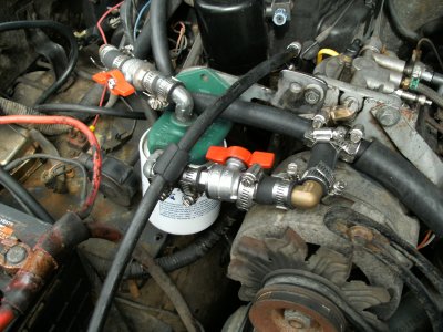

LOL! I'm "one of those people" my thought/worry being that in the winter the flow through the coolant filter would be slowed to such a point as to not provide sufficient BTU's to the cab heater, so I bypassed the bypass. Other than that it looks like we chose to mount our filters very similarly.

RIGHT YOU ARE ;Sweet ; but, if one uses a manual cut-off valve to prevent coolant cycling to the heater-core in summer, one MUST plumb in a VALVED summer-time "bypass" loop to keep the coolant flowing through the filter.
