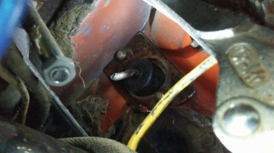

I am guessing what broke is called the push rod. How do I replace this? Do I need to take off the master cylinder?
I am going to get this clutch moving again first, then head to the throwout bearing. Will I need to drop the tranny? Im not sure about transmissions, so Im begging for oilburners guidance.

Sadly yes trans removal required for TO bearing...plenty of threads here on that subject thusly I wont go into details of it.
Yes that pushrod is replaceable. There is a retaing clip in the MC that must be released to get old rod out...I made a plastic sleeve from a funnel to slide down rod into MC to dissenguage said clips and draw out old pushrod.
Also the pin on pedal cross shaft arm and eye of pushrod ...how are they worn?? If so then that will need be addressed. If not worn yer lucky.

I ordered the clutch push rod from rock auto. Should be here in a couple days. I see the heim mod. Is that necessary only if your bushings and pin is worn?
Im going to have to make a tool to pull out the old push rod. Does anyone have any pictures or tips for this?

I used screwdrivers to get the clip out, then the rod just came out.
The heim joint mod can be done for any reason. Or no reason in particular.
In my case, the pin and eyelet were worn.
