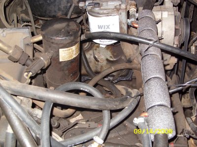

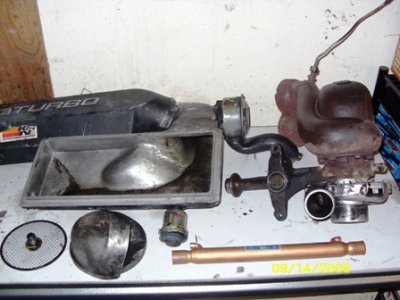

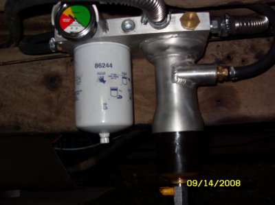

what heat exchanger are you running and do you have any pictures of your setup. thanks for the good info.

These pictures are not the best but they are all I have on my laptop. The picture with the turbo parts shows the heat exchanger before installation, the second shows it installed, and the third shows my Racor Voromax that I also use in my system. I hope this helps. If you have any questions lmk.
