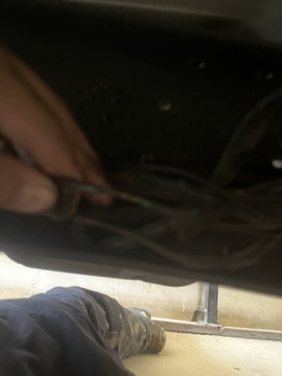

AHA peeled some random electrical tape back on some wires and lo and behold damaged wiring!
False alarm after repairing 4 wires still popes time to go rooting around in the column

Interesting, lowered the column and all the wiring looks fine I guess I’ll disconnect the switch and go for a drive
Update drive with turn signal switch disconnected still blew the fuse

When I rolled back the rubber I found those 2 but I don’t think this effecting the situation as still blew with switch disconnect
