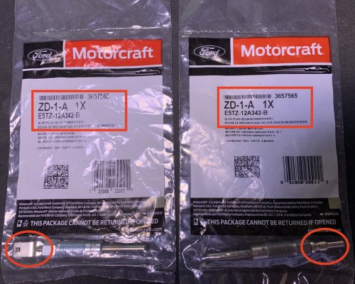

Since you can only buy SIX at a time from AMZN, I used two accounts. Out of the 12 plugs ordered in total only ONE is a spade. Since I now have 11 ZD9's, I would just change the harness and controller to the 87-92 version - but the labeling makes me think none of these are actual Motorcraft parts, that they're actually really good fakes.
Photo is enclosed - note the square boxes have the exact same part numbers. Sealed, original looking bags. The ovals - show the difference in the actual parts. It will take two hours to return these, and I have to go find another set.
So - I'm ONE for 12.

I dont think those are fakes, just mispackaged somehow??
Given all the other examples online, and the markings - I'm leaning fakes.
Doesn't matter. These are zero doubt ZD9's in very specific un-opened and factory looking Motorcraft ZD-1A packaging. Not one - but 11 of 12.
I've seen what happens with the cheap ones - I was lucky to get the damned things out.

Those are zd9s, I agree with that. What markings are you seeing that make you think they are fakes?

Packaging. One problem, no issues - things happen. 11 of 12 - nope. Could an entire manufacturing run be that way - certainly - but that kind of thing would get caught by the retailers. Also, the notes from other forums on verified fakes had clues which are evident. Aside from my photo, I'm not in possession of them any longer.

I still dont see anything that would lead me to believe they are fakes......and you give retailers WAAAAAAAY to much credit if you think they would catch that mistake.
I take interest in this because I replace between 10-15 sets of these a year, have a close to a hundred of them on hand, and want to learn of any ways to spot counterfeit stuff..........I dont by any auto parts from amazon though.

Are there small holes punched in the bottom corners of the bags?
I have posted this one before. It is from FordTechMakuloco, who I think is a member on here, or over next door at SDD. This is a video he has showing a bad fake, a good fake, and the real thing. They are 5.4 coils and plugs…. But pay attention to the bag information he shows….
Also, look at the markings on the plug itself. Do they say BERU on them, or is there another name on them?
