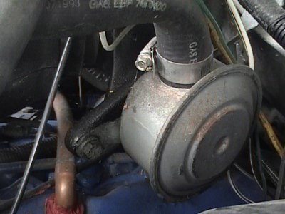

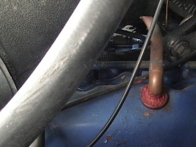

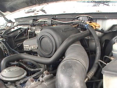

Yeah, there is large cast holes in the heads and block for oil drain back from oiling the rocker train. Tried to take a pic of mine yesterday, but it's covered by the Banks air intake.
Edit: Found some pics, not very good tho. The tubing is 1/2" copper.

looks familiar Thank you for them Pic's;Sweet. What did you end up using at the flange side
