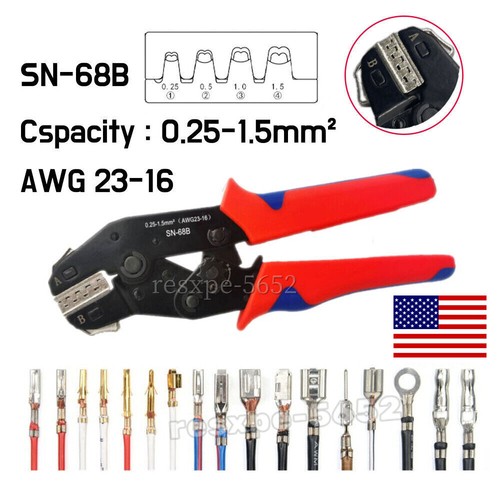

In the pdf, part number for pins can be found. As for the crimp tool, It took too long to get. Those are E key and there is A-E for choice, as in 18SE need changed to 18SA for A key.
edit: looked around found a cheap crimp tool not shiped from china, like the the one I got.
