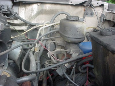

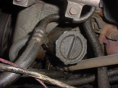

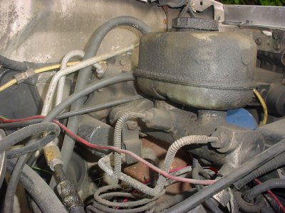

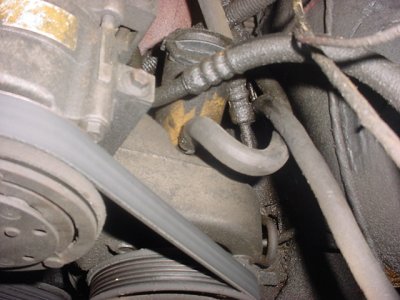

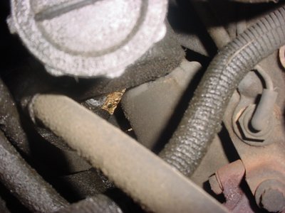

maybe these will help a little

Hey 450,
Thanks! I actually have it in now. I ran into an issue with one of the hoses on the newer unit. The hose that goes from the hydroboost to the steering pump had a different end on it than the original. It screwed in fine...it was a compression fitting. The original had an o-ring. I didn't pay enough attention, just screwed it in. It leaked badly on the test run. You could have followed my entired test run trail from the leaking hydraulic fluid. :mad: Instead of buying a new hose, I took the old end off my original hose and swapped it onto the newer hose with a compression fitting.
Will test it today.
