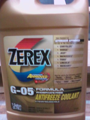

If you look at the G05 specs, it's Ford approved and Mercedes Benz among others. It's nothing new, they have been using this stuff for years in Europe where most of their cars are diesels. They are big on low phosphate coolant over there too, and that's why they mention it in the specs also.
I did days of research on this, but i don't think I copied any of the websites I ran across that explained all this stuff, but I came to the conclusion this stuff would work, was readily available, and not too expensive. I mentioned something about it when I picked it up at the Napa store, and the guy behind the counter said it's all he ever used in the Mercedes Benz diesels.
What I think is strange every time I check the coolant, it looks like dirty water. It comes that way out of the jug. I am so used to coolant being green.

Cool. Will do on the results when i get mine put in. as far as the coolant goes i had originally baught fleet charge, but after learning about coolant on here i decided to err on the side of caution. so i returned the fleet charge and i went to car quest and baught 5 gallons of Zerex GO5. it was $17/gallon for me but i am more comfortable with the fact that it specifically says that it contains stuff that protects alluminum.
So to make that nice and i clear...i will be running Zerex GO5.
I could not find it at oreilys or auto zone. don't know about advance auto though. but car quest had a ton of it.

I also was wondering about this coolant, everyone says the CAT ELC will eat your oil cooler o-rings... what about this?
never heard that before.:dunno
The low silicate coolant has the proper additives to prevent corrosion of the engine metals.
Fleet charge is good with aluminum, lots of AL parts on trucks these days.
I use the Zerex in mine, except for leaving it all on the hiway east of Butte.
