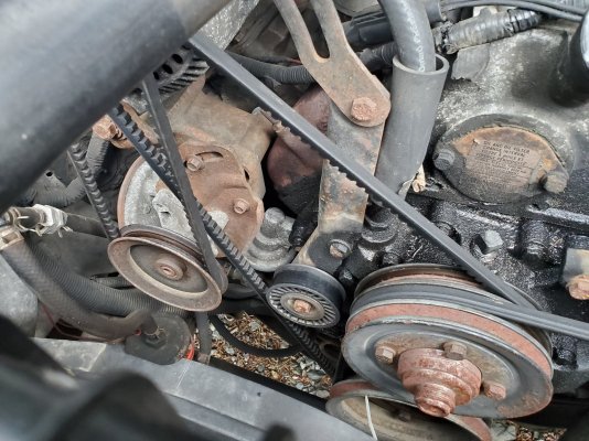

I have found a fix, though I can't remember what car it was out of. It's just a serpentine idler from a 2000-ish Mazda somethingrather but it works awesome. Haven't lost that belt since I put it on years ago.
As for tensioning it tighter, I did that for 3 belts before I got fed up and found an idler in the salvage yard. Admittedly they weren't Gates belts but still, I lost 3 in less than a year. One NAPA, one Orielly and one more.
Obviously I was able to use the third bolt hole on the alternator adjustment bracket. I'm pretty sure I had to find a bolt but that's small peanuts.

It looks a lot like the belt tensioner pulley from an early 2003 Ford Taurus. The 2003 Mazda Tribute's tensioner pulley looks the same but with a different tensioner. (pic is a Taurus one)

Pulley should be on the back side of that belt. Not the v side
