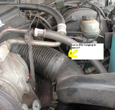

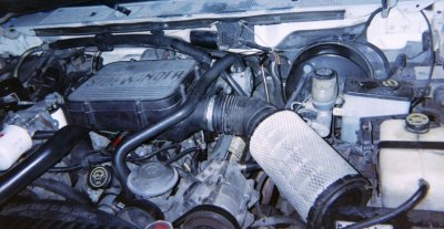

I was looking at the air intake once again contemplating the Zigg air intake. (By the way no write-up on that in the tech section?)
Anyway I got a couple of questions - what if I get rid of that flat plastic part that slips under the hood and just leave that plastic tube coming off the air filter housing. Would the air right there be much to hot? Wouldn't this be better than leaving that flat part. I mean at least it could suck as much air as it wants to even though it might be hot? Anyway thoughts, suggestions. Thanks

Eric I think the colder "ram air" effect would be better than sucking all that hot air in from under the hood. I have my air filter set up (open element) just behind the drivers batt. I cut down my air scoop to direct the air to the open element. I'm not sure if it helped or not but it make me feel better

Hey Russ, actually minus the open air element (I had planned on leaving the filter in the orig ATS housing) your setup is exactly what I'm talking about. Aren't you sucking in hot air too? Oh on re-read...what is your "air scoop" to direct to your open element?
That's the way I have it on Lady Moose right now.

You've removed the flat part going up to the front of the hood? And you left just the tube coming off the air filter housing? I take it you've had no ill effects from this then. I was thinking of just running like this for awhile until I could do the setup like Ron or Darrin's and see if anything changed...I just wanted to know whether this would hurt anything first. I'm starting to think about getting more air in and then I'll work on getting more air out (also following Darrin's exhaust suggestions)...getting ready for towing the TT again. After we turned up the fuel last year she climbs to up in temp pretty quickly! :eek: That's why I was wondering if for the short term it would be ok to remove that flat part.
Thanks for all the suggestions and comments.
