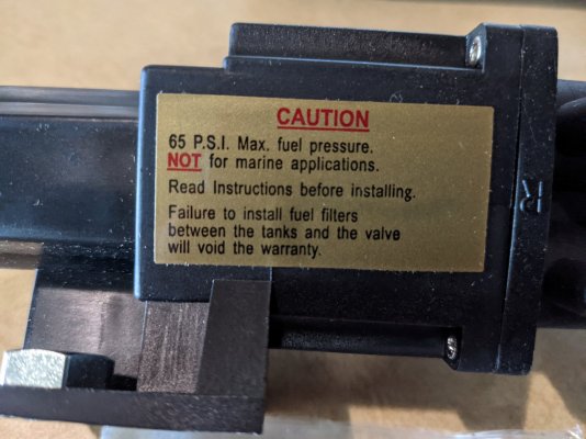

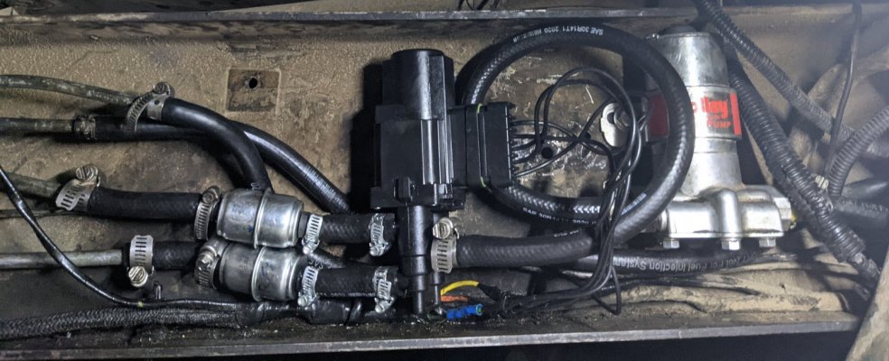

Maybe the valve is already clogged up. Did they put filters like the valve instructions say to do? No warranty without them.

No filters but they replaced the fuel pickups. A clog couldn't allow air into the system - it would stop the flow of fuel.

Some thoughts-
1) Mabye you have air intrusion on one of the lines to the fuel selector now. May not leak out at standing pressure but under suction let’s air intrude.
2) Bucking for me has usually been fuel starvation. Air intrusion to the lift pump could cause a lack of fuel and bucking, especially at higher rpms with your foot into it.
3) When my fuel return lines leaked and caused hard starts, it only took 2-3 minutes to clear and no further problems till it sat. Your return lines are after the IP and under pressure, so a air leak there causes fuel to leak out. Only when shut off do they let air in.
4). If the bucking is consistent I would blow air from the rubber line going to the lift pump back to the gas tanks. Take off the gas caps, blow say 10psi, do it for both tanks, and see if things improve.
5) Some have put a 5 gallon gas can with diesel in their bed and hooked to the lift pump to test the fuel availability system. No bucking it’s lift pump back. Still bucking its lift pump forward.
Post pics and share what you are testing.
