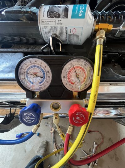

Forgot I had one that I never installed, so that was easy now shes runnin and blowing cold, how are these pressures lookin?
It’s 87* outside right now

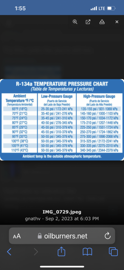

Try this. Looks like you‘re still low.

You'll want to reference the pressure/temperature chart for manual filling.
If you're having a hard time adding more, a trick I use is to run the system, and fill off the suction line (low pressure) as it will literally suck the can empty.

It’s 73* outside so let’s round to 75
According to this diagram I should be L35-45 H 150-170
It would appear my low is too low and high is too high

Here is a basic guide, it's approximately what I have done in the past.
Pressures seem alright to me, does it run cold? Was it originally an R12 system?
If the pressure seems right I’m pleased it is some very very cold a/c coldest I’ve ever felt for an r-134 conversion by far
I guess I’m just being a little over concerned I don’t like to have to do stuff twice
2,290
2,311
Temerature readings should be taken at the fittings, and expect a variance of about 5-7 degrees.l due to thermal loss.
With low too low and high too high, either wrong orifice or undercharged.
