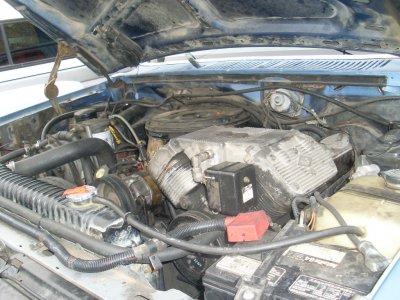

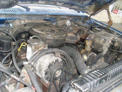

I got lucky, my 84 F350 extended 6.9 stick dually already had a heavy-duty air compressor installed when I got her, it's a 'V type' pump too.
40cfm @160psi :D
it's built to run 1" big rig tire guns.;Sweet
